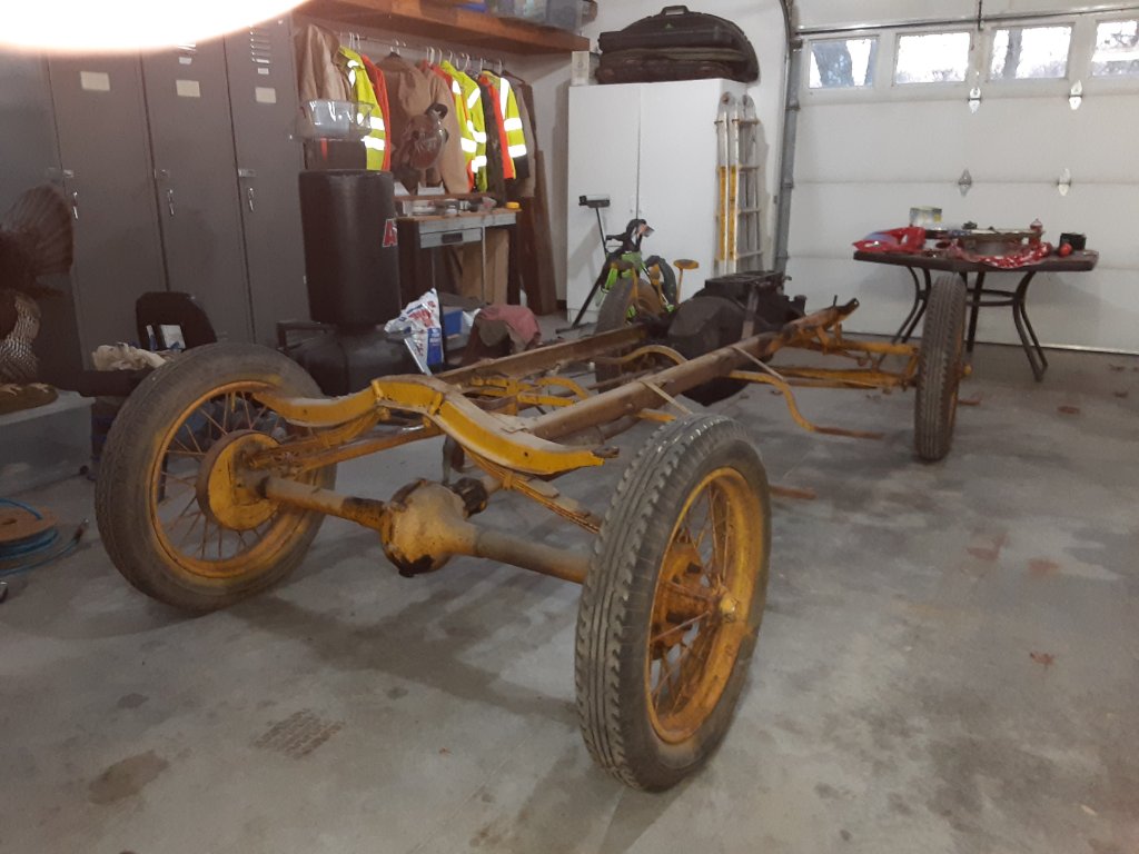

We have removed the body and engine. My grandsons (18 and 21) and I want to paint the frame. I have questions and need suggestions/comments on how to proceed. I will have a shop blast clean it.

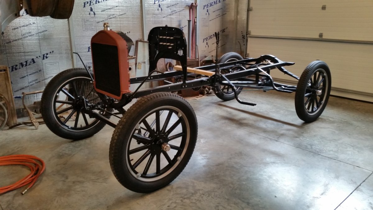

You will get different ideas about which type of paint to use also. For me Rustoleum black that’s used on machinery, farm equipment and etc works well and looks good also. It’s durable paint that lasts a good while.

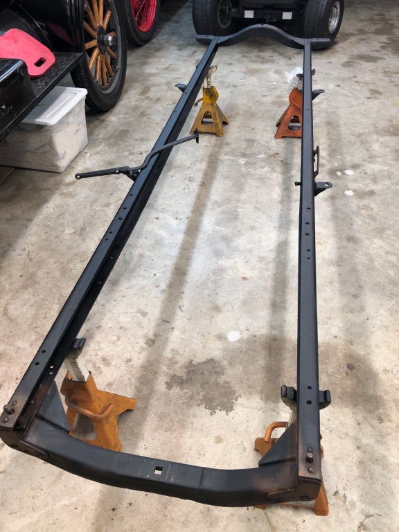

Re: Questions About Painting the Frame of a 1927 Coupe
I did the frame below with a brush and rustoluem satin black...

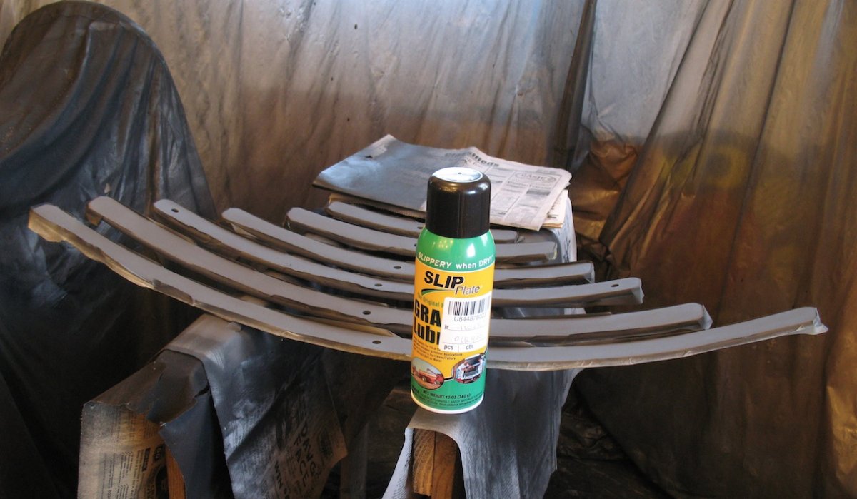

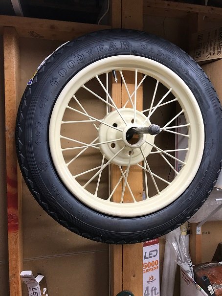

I painted these with Rustoleum Farm & Implement International Harvester White Enamel Paint - It has cured very hard and looks good and I enjoyed doing it - this is the extra spare tire. I am not wanting my project car to have an over-the-top finish, just one that looks like it might have been.

Springs should be metal to metal with some type of lube such as slip glide, graphite or grease between the leafs to allow free movement between the leafs. Paint or powder coating diminishes that movement.

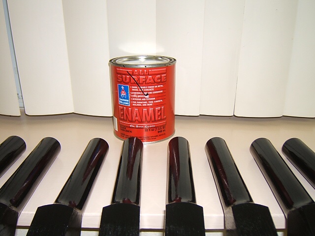

I never sandblast, because it alters the original smooth steel surface to a very rough, grainy surface. If the paint that is on there is still good, with no rust present, you can clean off the old grease and dirt with mineral spirits, sand the paint down to a new layer and brush paint with gloss black enamel. You can paint enamel over lacquer, but you cannot paint lacquer over enamel. If the old paint is too far gone, and it needs to be removed, it is best to strip off the old paint with Jasco gel type paint remover with a wash of lacquer thinner. If there is any rust under the paint, clean with several applications of Muriatic acid and once all the rust is off, neutralize and flush well with a mixture of baking soda in water until it stops bubbling. Make sure to allow the baking soda solution to seep in under the riveted joints to neutralize the acid between the joints then rinse with clean water. To prevent flash rust from forming after rust removal, dry with a towel and quick dry using the high setting of a heat gun. About 1,200 degrees F.
Best to apply primer and paint by brush in order to dab the coatings into hard to reach places under riveted parts. Spray coating these hard to reach areas may leave bare spots. Brush Prime with a good quality Red oxide primer such as Porter Paints red oxide primer and brush on a good gloss black enamel. I like Sherwin Williams gloss black enamel as it levels out very smoothly when brushed on. Gloss is best because it is very smooth and slick which sheds dirt, road grime and oil film more easily. Jim Patrick
PS. In the below photo, the spokes were brushed with the gloss black enamel and you can see how well the enamel leveled out to a smooth shiny surface without brush marks.

Some people paint the springs as a unit. I take them apart, paint the individual leaves, and apply Slip Plate on the bottom of each leaf above the bottom one.
