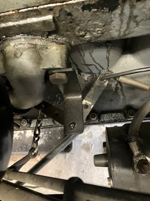

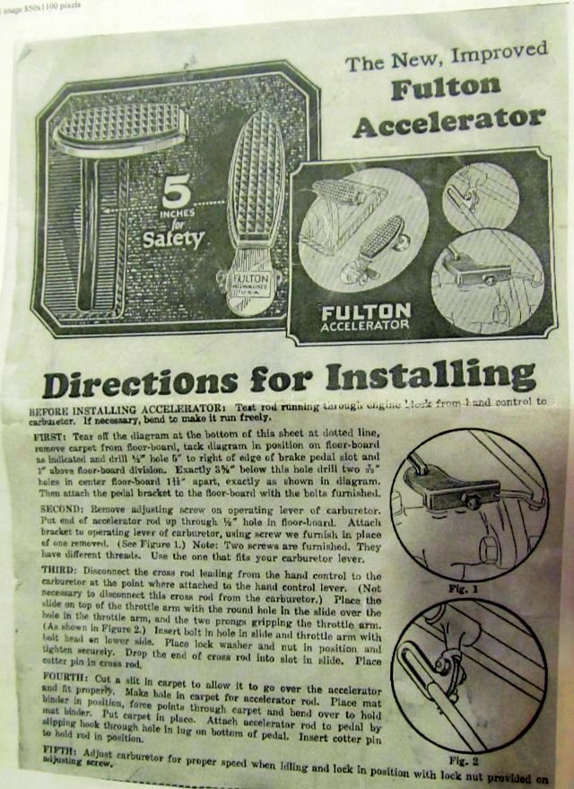

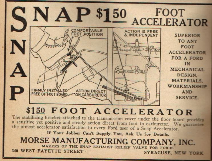

There were accessory kits available from the suppliers years back, besides back when.

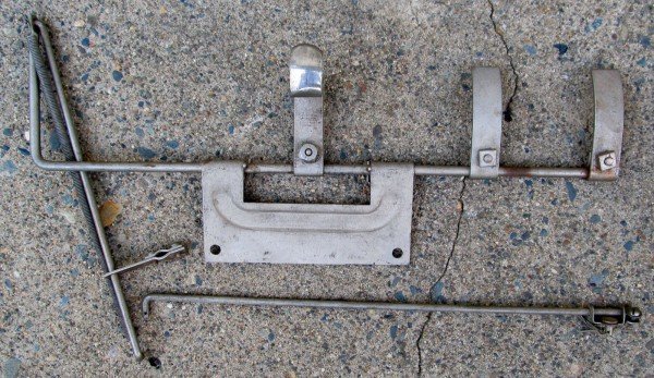

More ideas
this uses the Vaporizer to Holley carb linkage as part of the design
Using the Vaporizer Throtlle Linkage requires that you also need to have the Conversion linkage for the Vaporizer to Holley NH kit --
https://www.mtfca.com/discus/messages/1 ... 1276459118
https://www.mtfca.com/discus/messages/8 ... 1245269322
Link to this option https://www.mtfca.com/discus/messages/1 ... 1299819284
the peddle part is still sold by some suppliers https://www.macsautoparts.com/1928-31-f ... 939-1.html https://www.mtfca.com/discus/messages/2 ... 29461.html
The Model A (1928-29) design can also work - put not there parts.
More ideas

Texas T Parts used to sell one that works well. I bought one before Bird Haven bought them out and it disappeared. It would be easy to duplicate.
- Posts: 6539

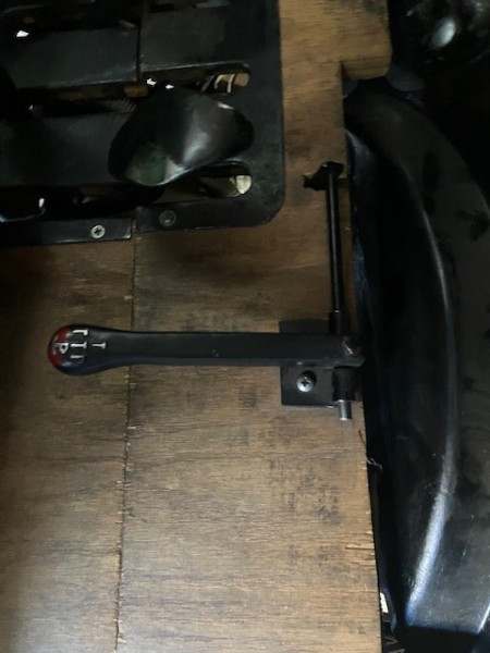

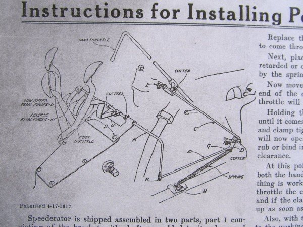

Re: Ideas for a column throttle and foot-feed combination (Pre-1926)
Thanks for the pictures & instructions. I have one that I was thinking of using, now its a no brainier.

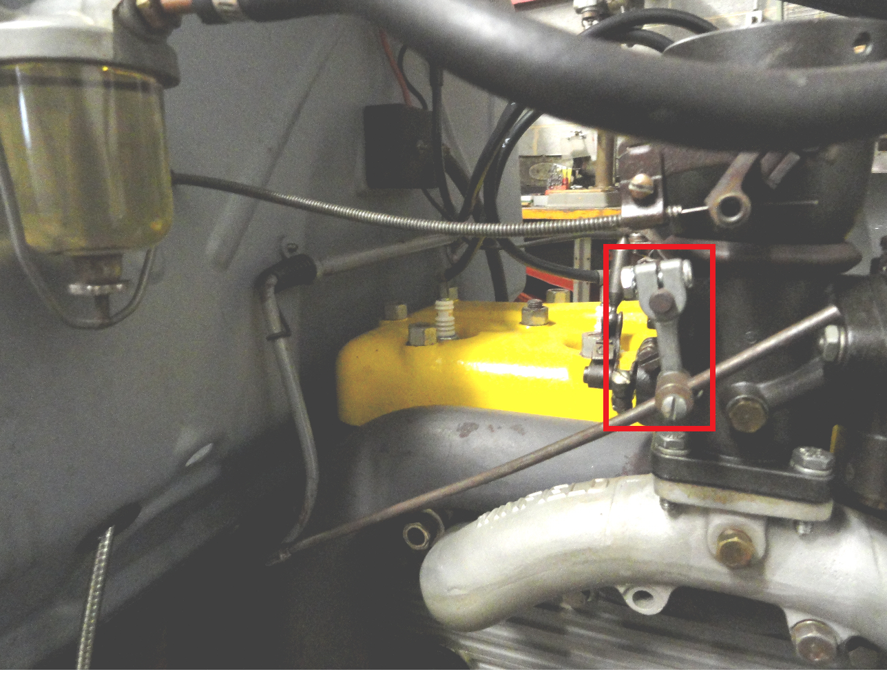

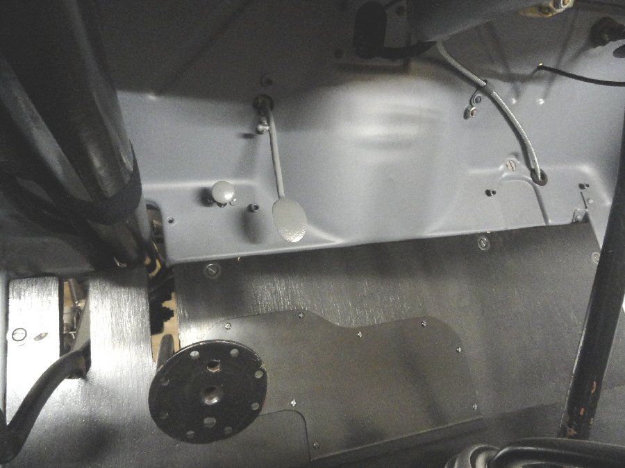

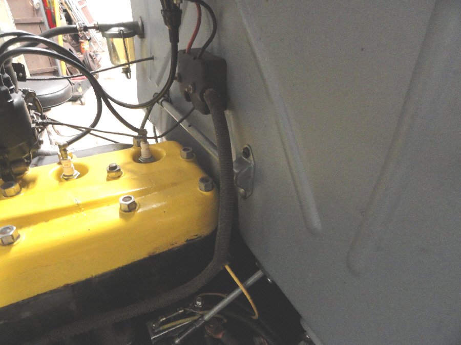

I found this for a Winfield down draft carb on a Model A. Very simple set up. The arm on the carb is a modern part sold by Speedway etc
Model A (28-29) has a bracket that attached to hogs head ears (bracket doesn't fit a Model T nut one could be made and then the rest added .
The arm on the left is attached to the throttle rod (need to find picture) and the arm on the left is hooked up to the carburetor (need picture)
