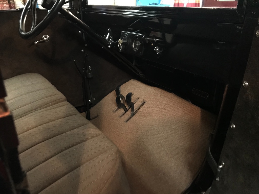

I am redoing some of my coupe's interior in brown. Door panels, kick panels, carpet, and possibly the headliner.
Can anyone spare some pictures of their restored interiors?
My coupe has no windlace/weather stripping. Any reasons I shouldn't add some?
I would like to keep it as "factory" as I can, but I will be doing the work alone and could use some guides.

This is the brown kit I put in my Tudor several years ago.
Not knowing, I put the headliner in after the top was on. It was possible but not the best way.

Many thanks so far for the pictures and information.
I have noticed some cars have the seat pattern for door panels, and some have headliner pattern.
Is one more "correct" than the other? Both look good.

I have an all original 1925 coupe with all original interior, if you want to keep it that way, let me know, Thanks, Bob.

Hi, here are the interior pictures of my original interior. I did not get your PM. I hope this helps, Bob.

A hearty thank you to everyone for the pictures and insight. My headliner is interesting but definitely not original, thank you Bob for the pictures of your time capsule!

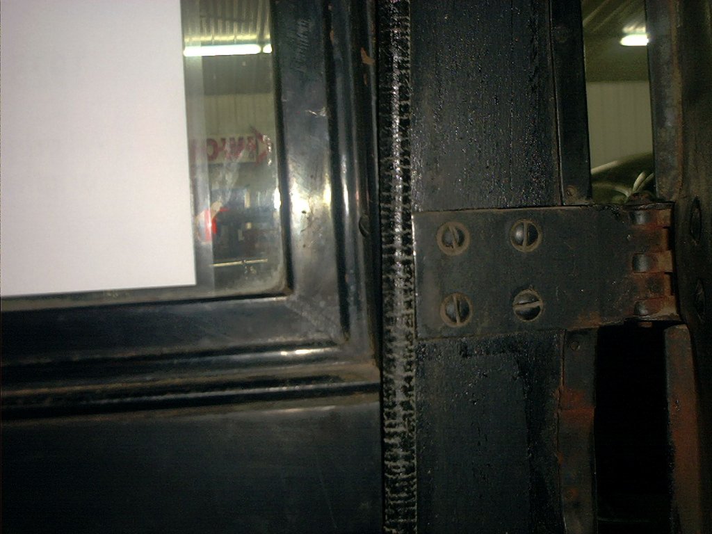

Can anyone spare a photo of where exactly the windlace attaches to the doors?

Post by Rich Eagle » Mon May 02, 2022 4:26 pm
Tad, the windlace attaches to the doorway under the upholstery panels with the panel brads.
