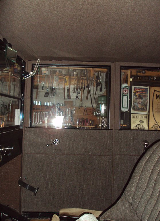

Re: 1925 Coupe Interior
This is the brown kit I put in my Tudor several years ago.
Not knowing, I put the headliner in after the top was on. It was possible but not the best way.
Many thanks so far for the pictures and information.
I have noticed some cars have the seat pattern for door panels, and some have headliner pattern.
Is one more "correct" than the other? Both look good.
I doubt my ‘25 shown above is correct but that is the way the previous owner had it re-done. No reason I can think of why the seats are gray and everything else brown but it is what it is!

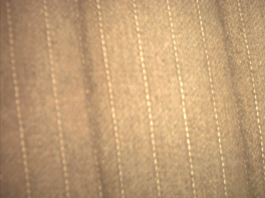

Here is what I am looking at now, I am having a hard time matching material to my headliner. Does it look like it was redone at some point?
I seriously doubt most folks went back to their Ford Dealership when it came time to replace upholstery. Probably went to their local small town furniture upholstery shop and bought any style and color that pleased them. Thus all the off colors and styles from original.
- Posts: 4691
https://www.google.com/search?q=caudaro ... ent=safari
Go here and you can see almost the same material and color. Scroll down a bit and you can see it. I think what you have is caudaroy.
I admit, now that you bring it up it looks and feels like corduroy. I think my best bet is to match it on the upper door panels between and above the windows, then do the rest of the door/side panels in the same pattern as the seats.

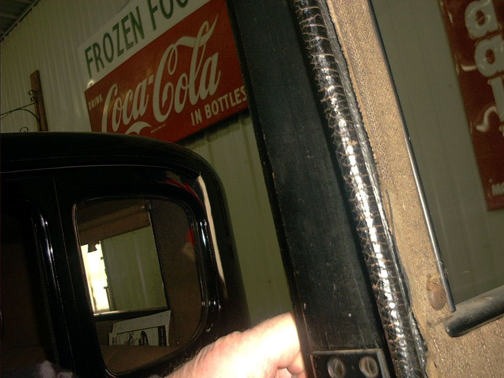

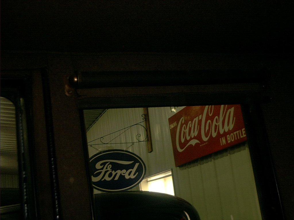

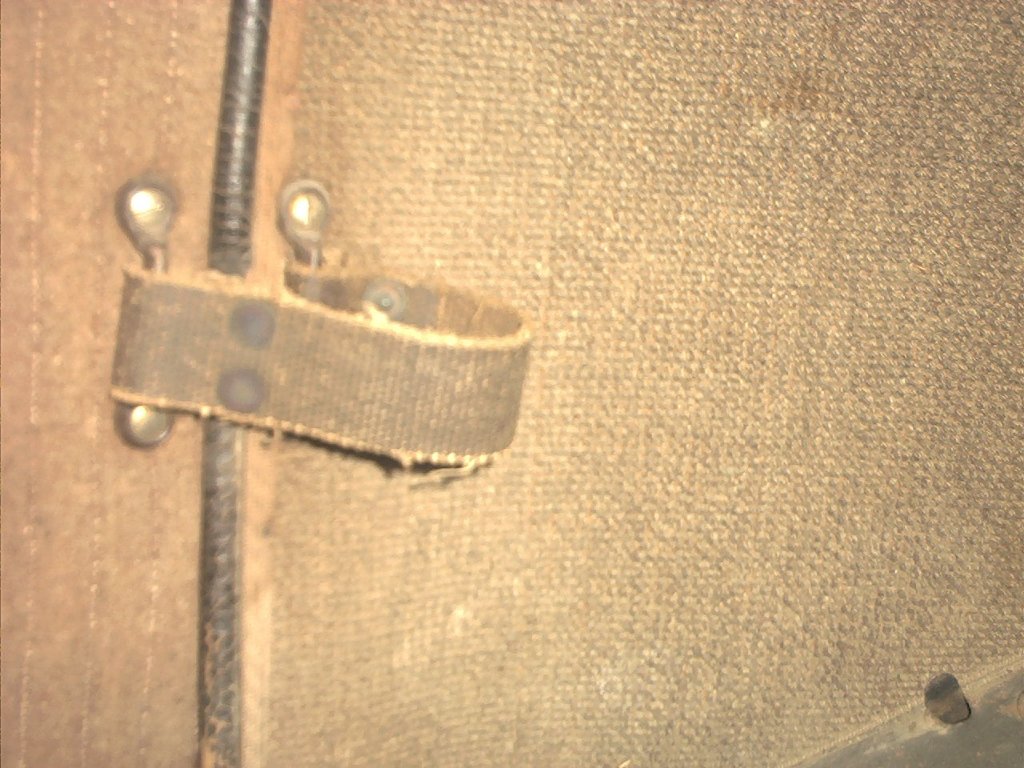

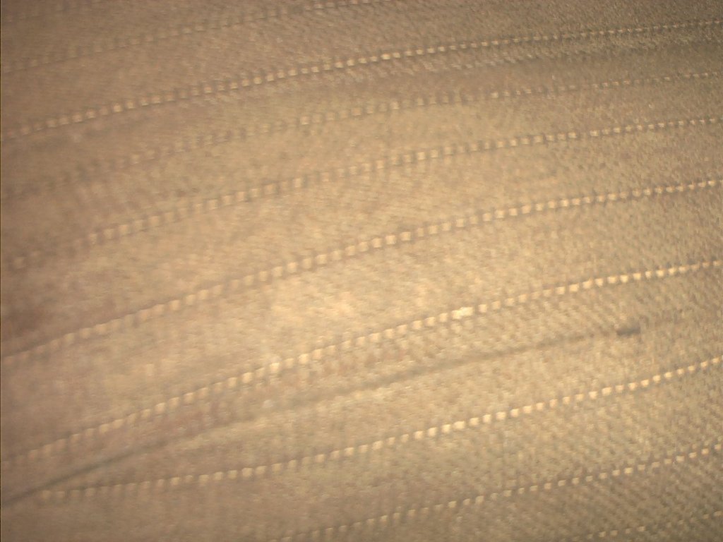

Hi, here are the interior pictures of my original interior. I did not get your PM. I hope this helps, Bob.
Can anyone spare a photo of where exactly the windlace attaches to the doors?
Tad, the windlace attaches to the doorway under the upholstery panels with the panel brads.
