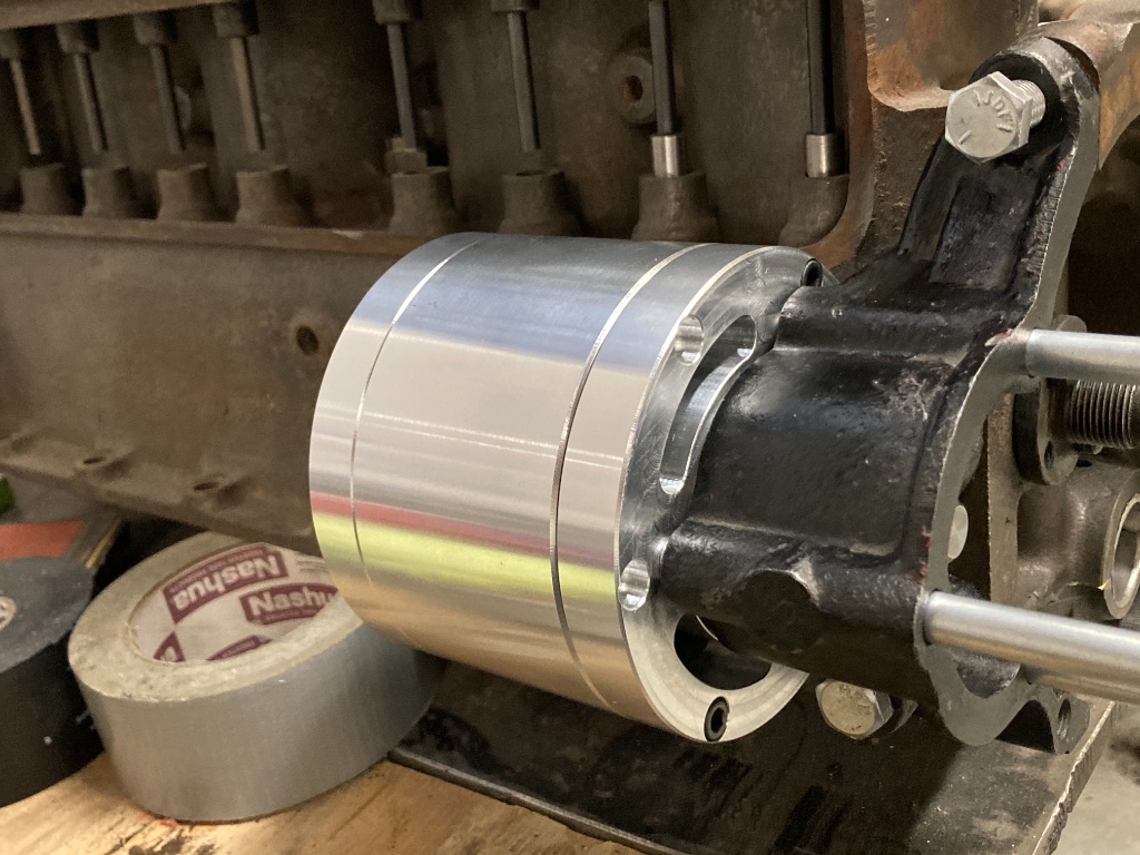

Making what I was hoping would be the final fit check this evening, and the alternator with all its guts is fitting great! Did find there was some extra material on the inside of my generator mount that was going to require some minor grinding... but looking at a couple other generator mounts, the clearance issue is limited to the one piece.
Then I put the pump adapter on... don’t know how this slipped thru the design phase...?! I’ll have to take a look at the one on my speedster to see how I routed the ports...

Only had a few hours today, so the goal was to complete a testable alternator. I got the air vents machined in the housing, modified the rear housing plate per the revision to the oil pump adapter, and got a rectifier/regular on order.
I made some progress on the revised oil pump adapter plate too… but didn’t make it to the port fittings yet, so can’t test for clearance. The design moves the fitting 5/8” so should have plenty of room for the tube nut now.

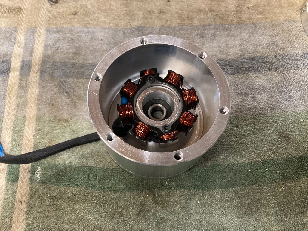

So… a month ago I assembled this darn thing, and the best output I could muster was measured in mA. My dad messed with it, a friend messed with it, I messed with it, 4 regulator/rectifiers were purchased between us all, then I finally broke down and took it to a rebuilder to test. I picked it up today, and he says it charges 14A! Exactly what it should! How could this be…?!
In the meantime, I ordered an OEM dynamo that came in today. I assembled the stator and magnet ring into the extra housing I had built, and it works great! 15.5V 17A at 2000 rpm (1325 crankshaft) with the same regulator/rectifier as used a month ago. The same test with the original dynamo now yields 15.5V 14A. Did it heal itself…?!
I must have rubbed the varnish off of the stator wire and caused a short somewhere during the many assembly tests. Next step is to put it back on a car to prove function👍
