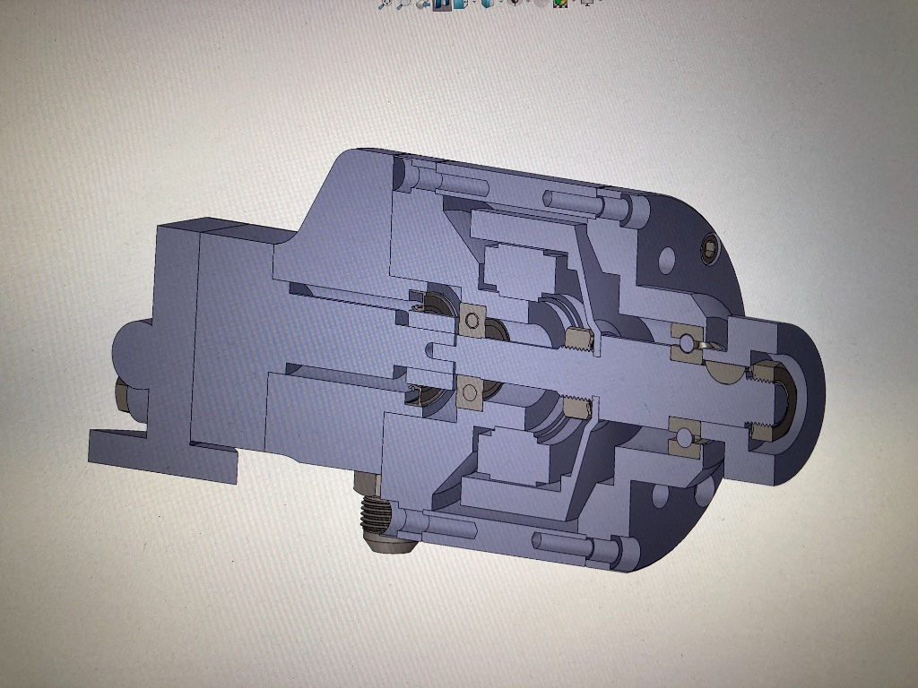

Here is a shot of the design so far. Only about 4.5” diameter and 9” long with the oil pump installed, so no more intrusive than the original genny.
All I have to power is the LED headlights, fuel pump, ignition, a few gages... and maybe the electric water pump. Good luck getting seat heaters in this car! Don’t tell my wife I said that

might wish to rethink the risk of having a nut retain the gear and I'll bet you already are...

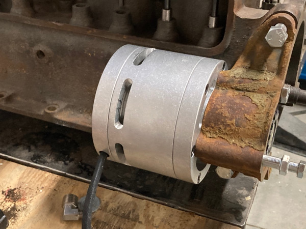

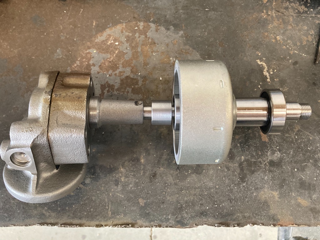

Had some extra time thru the weekend and was able to make up the center shaft for the alternator, and modify the input shaft for the oil pump. After machining a slot in the oil pump shaft I pressed on a collar to prevent the shaft from splaying open under load, and also will have a seal running against the OD. The Datsun pump has an oil squirt hole that is fed by pump pressure to oil the dizzy drive gear. The seal will hold back the oil, and am currently devising a way to scavenge the oil back into the circuit. The magnet ring was also bored out to fit.
A little birdie told me that someone had mounted a similar dynamo to the fan pulley on their T, but was removed as it ran hot and didn’t charge enough. This is concerning... but I will press on! A bit of research shows a near identical dynamo rated at 20A (this one is 14A), so may pick one up to examine the internals. Will also be adding a series of ventilation slots around the housing
I considered the VW pump years ago when I built the engine (the pump and adapter went on to other engines). I chose the Datsun after seeing the internal plumbing hassle of other engines, and others I have encountered loosing their prime. I would have liked to run an original (or built one) gear type pump that was front plate mounted, but the right combination of accessories was never there at the right time. I’m certainly no stickler for authenticity with this car... but certain modern attachments stick out like a sore thumb while others are incognito. The sore thumbs are what I’m lookin to reduce. When the Akron-Hed is running and all is well, I’ll start contrapting my 4 wheel hydraulic drum brakes... that’ll be part trois...

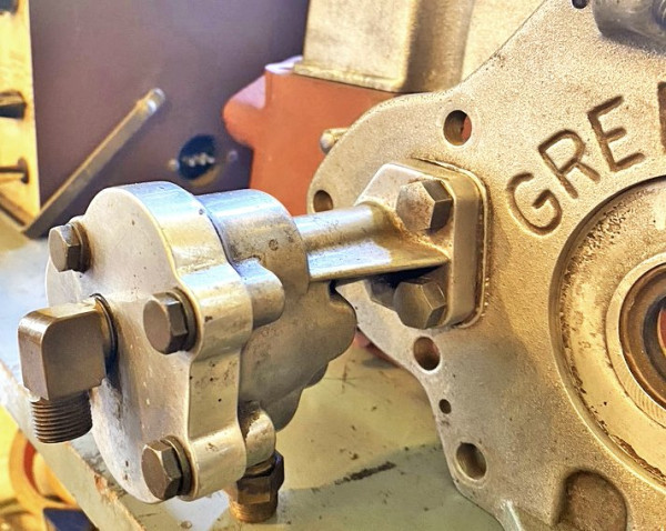

Another option for the oil pump is a flathead V8 pump driven from the back of the camshaft. I have now done it several times and I will share my experience. In my opinion the big plus is that it eliminates any concern about pump priming.
David Greenlees
- Posts: 174
- Joined: Wed Feb 02, 2022 1:18 pm
- First Name: David
- Last Name: Greenlees
- * REQUIRED* Type and Year of Model Ts owned: 1915 Model T racing car, 1924 Model T Depot Hack with original York #803 body.
- Location: Brattleboro, VT
Re: Playin in the shop today... round duex!

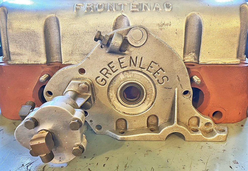

Not all external oil pumps will lose their prime. I made the patterns and had a batch of oil pump covers and this front plate cast in the 1980s and machined the covers and front plates. It can be driven off of the generator shaft, a mag shaft, of any other side-drive shaft. This prototype was extensively tested for 15K miles before any of them were sold. If the pump cover is carefully sealed to the pump casting, it will not lose its prime even after not being used for years. Most of the lower half of the pump always stays full of oil, and the pump will come up to full pressure in less than 3 seconds after starting, which is as good as any modern gear pump will perform.
It is used on both full pressure, pressure to the mains, and recirculating systems. I sold 20 of these systems, and all of the purchasers reported good results; some I'm still in contact with even after over 30 years. I may make up another batch of these someday if I can find the time.

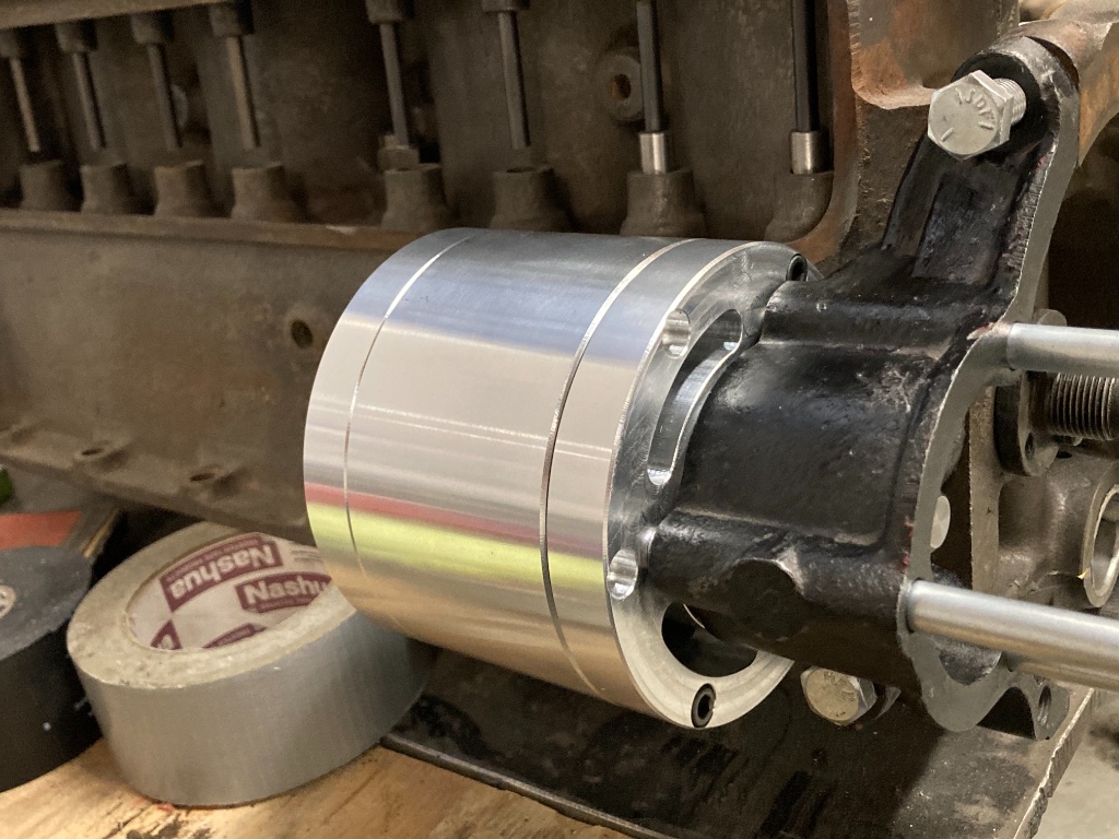

Making what I was hoping would be the final fit check this evening, and the alternator with all its guts is fitting great! Did find there was some extra material on the inside of my generator mount that was going to require some minor grinding... but looking at a couple other generator mounts, the clearance issue is limited to the one piece.
Then I put the pump adapter on... don’t know how this slipped thru the design phase...?! I’ll have to take a look at the one on my speedster to see how I routed the ports...

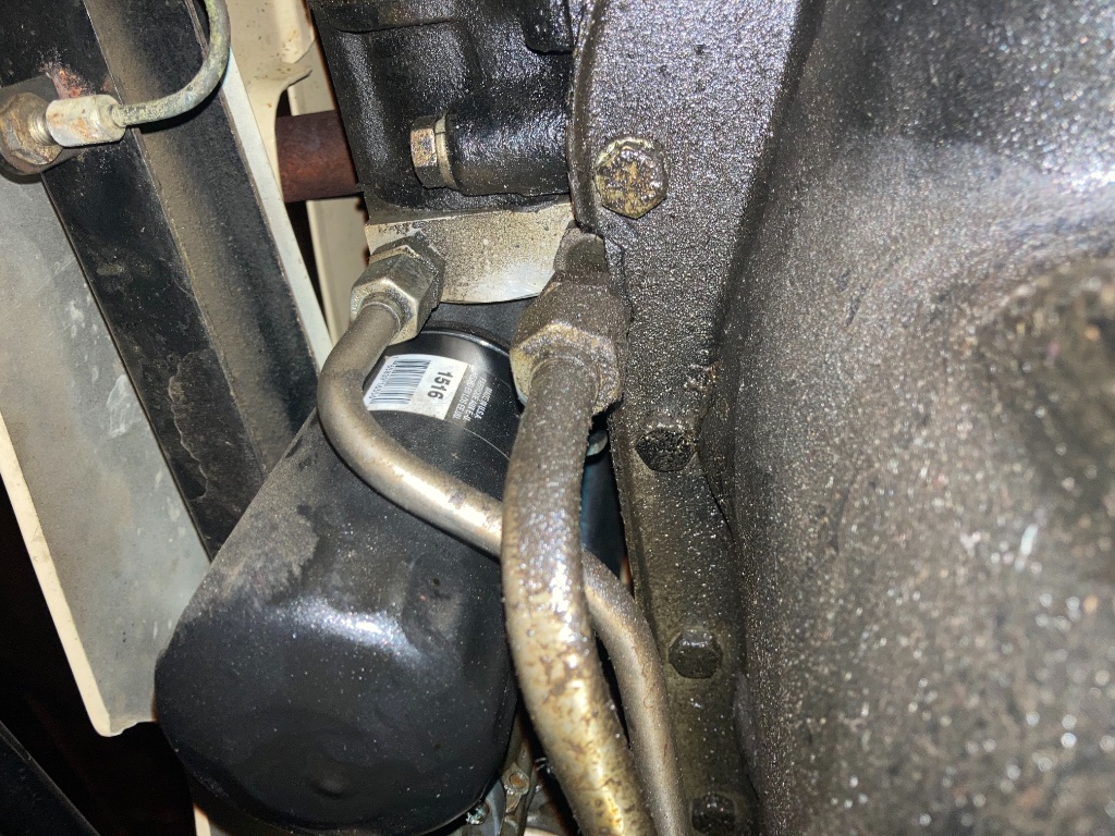

Haven’t looked at this ol pump in many years... and don’t remember the suction fitting being this tight against the block (or this dirty!). Apparently, I silver soldered an extended fitting to move the flare fitting below the pan rail and notched the pan for clearance...
Kevin Pharis
Topic author - Posts: 1656
- First Name: Kevin
- Last Name: Pharis
- Location: Sacramento CA

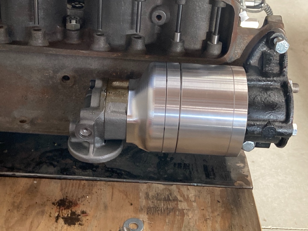

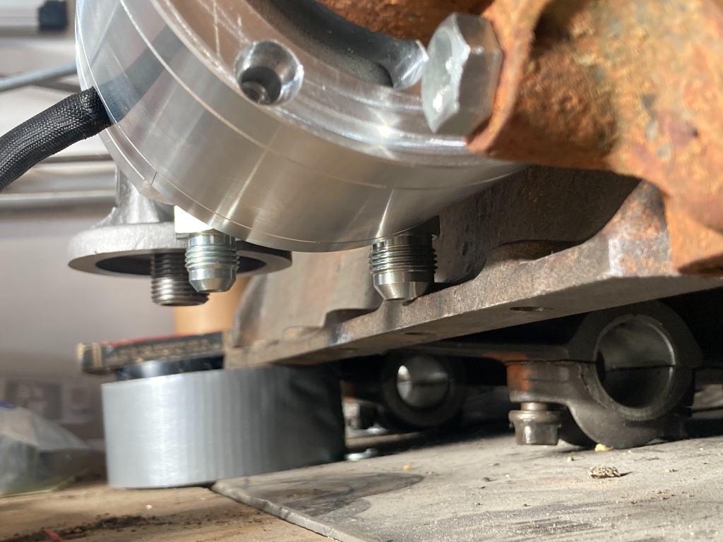

I have a plan! Was able to move the suction port .625” away from the pan rail. In the pic above, the oil pump adapter plate was slightly rotated, when in the correct position the suction fitting just barely contacts the pan rail. Now there should be plenty of clearance for the tube nut without trimming the pan or building special fittings
I also rigged up my cordless drill to spin the alternator... the drill is rated for 2000 rpm (1325 engine rpm), and the alternator was generating 12.75V AC. Seems promising, but still too early to tell... need to pick up a regulator and try it on an engine!

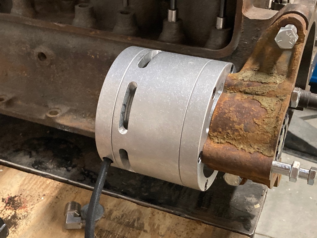

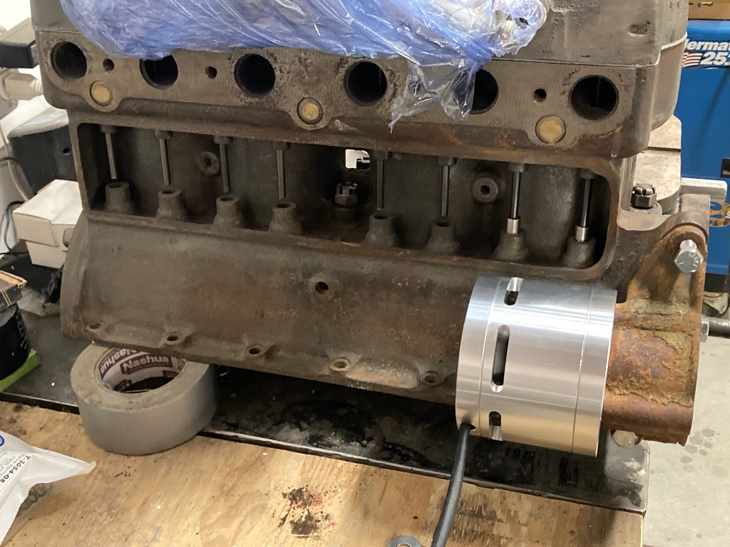

Only had a few hours today, so the goal was to complete a testable alternator. I got the air vents machined in the housing, modified the rear housing plate per the revision to the oil pump adapter, and got a rectifier/regular on order.
I made some progress on the revised oil pump adapter plate too… but didn’t make it to the port fittings yet, so can’t test for clearance. The design moves the fitting 5/8” so should have plenty of room for the tube nut now.
More progress and testing will have to wait till next weekend, as work has me traveling…

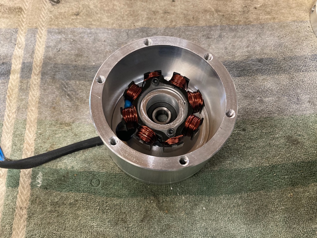

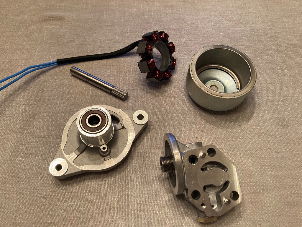

So… a month ago I assembled this darn thing, and the best output I could muster was measured in mA. My dad messed with it, a friend messed with it, I messed with it, 4 regulator/rectifiers were purchased between us all, then I finally broke down and took it to a rebuilder to test. I picked it up today, and he says it charges 14A! Exactly what it should! How could this be…?!
In the meantime, I ordered an OEM dynamo that came in today. I assembled the stator and magnet ring into the extra housing I had built, and it works great! 15.5V 17A at 2000 rpm (1325 crankshaft) with the same regulator/rectifier as used a month ago. The same test with the original dynamo now yields 15.5V 14A. Did it heal itself…?!
I must have rubbed the varnish off of the stator wire and caused a short somewhere during the many assembly tests. Next step is to put it back on a car to prove function

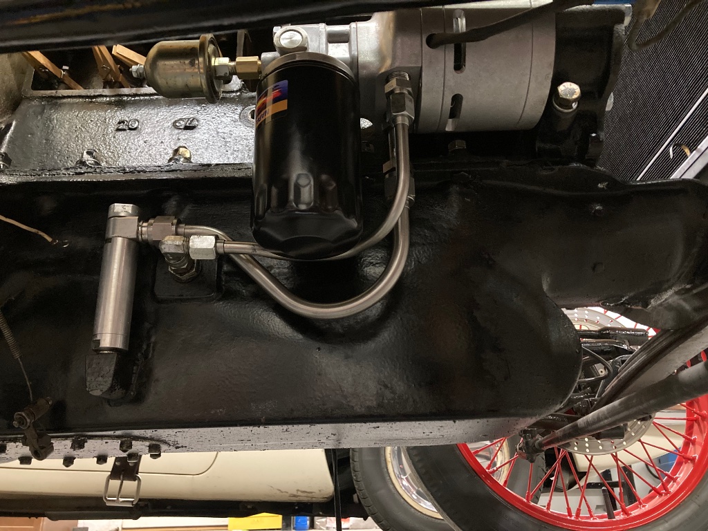

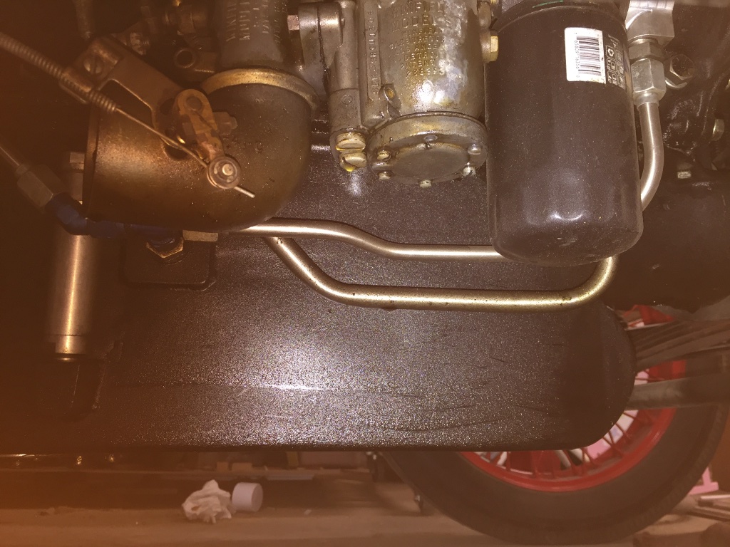

Got the alternator final assembled and bolted to the motor last weekend. Tonight’s project was making new oil lines DUN!
